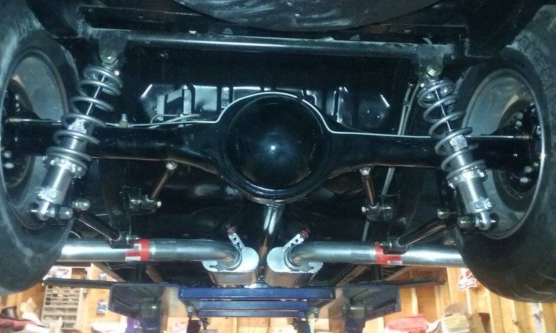

I have the triangulated control freak set up and Viking double adjustables, I don't have the HP/torque you have at only 550 from a port injected roller 408. but I also don't have the weight or bias you do (scaled at 2960 with 1500 even on the nose). with 2" per side narrowed rear and 325/50"s it hooks hard and straight, is extremely adjustable and they were great to deal with. The frame rail brackets are welded in but are inboard also. the only change I made was to make the lower axle bracket a little lower (1-1/2") for ride height. It works very well with the HDK set up. I use a 12" ride height shock with 4" stroke

I can set the 4 bar in my Hemi Duster either as a parallel 4- bar or configured as a 4-bar / 36" bars w/ about a 5" instant center.
IMHO....the parallel is more of a street friendly set up....with the bars parallel, there is virtually no bind or pinion angle chage thru up/down rear movement.
On acceleration , the rear tends to sucks the car down.....I'm from the school for best launch, you do not want the rear sucking down...or raising / pushing up. You want the rear staying neutral and all energy moving the car forward. the parallel set up wil also roll thru a corner better......no bind. A plus for cornering.....no big deal on drag cars
Most triagulated 4-bars do a nice job of locating the rear end, but they do not have the advantage of a 4-bar with the correct instant center. The lower bars locate....the upper bars transfer /apply the energy to the frame.
I see a lot of parallel 4 -bars in street rods, hot rods with low to mid hp....but never in a competitive race car with 900 plus hp.
Mine falls into the "limited" street use (not daily driver) and after running both configurations, I opt to leave it in the 4-bar /non parallel package.

I designed it, built a jig out of plywood and L brackets (I just came across it moving stuff to my new shop) and had the guy that welds my K frame packages (Fog) tig it up for me.
there are pictures of it on the first few pages and thru out my HemiDuster build thread good picture on page 2, post 28

I see the confusion.....I do not run a triangulated 4-bar configuration.
I run the bars in a standard 4-bar / 4 link configuration ......in line with one another. The parallel refers to the plane of the bars....both upper and lower bars run parallel to one another....no instant center. (imaginary point where the upper and lower bars would intersect)
triangulated (in triangulated 4-bar) refers to the top bars (only) .....one from each side that basically make a triangle IF you added a imaginary line between the frame mounting points......the only function of this configuration is to keep the rear centered without utilizing a panard bar, watts link, or diagonal bar ...or some other centering device.....NOT maximum traction.
the configuration of the bars on a drag racing set up IS for maximum traction.....NOT to locate the rear.

Nice build . I wish that I had the knowledge for a build like that. It's going to be a wild ride. That's the 4 link I need , but don't want to cut frame . I guess you can't have everything. I don't think you will have any problems hooking up.
