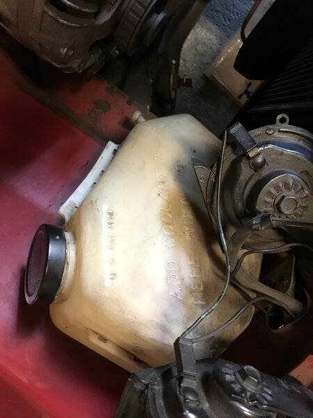

H Harveybos Member Joined Feb 6, 2008 Messages 9 Reaction score 1 Jun 26, 2020 #1 Anyone seen one of these before? It came fitted to my 69 Dart Custom. Appears to be an aftermarket part that connects to the radiator overflow pipe.

kursplat Well-Known Member Joined Aug 24, 2010 Messages 4,310 Reaction score 3,322 Location so cal Jun 26, 2020 #4 it's a coolant recovery tank. are you going to use it? nice period, albeit aftermarket piece.
H Harveybos Member Joined Feb 6, 2008 Messages 9 Reaction score 1 Jun 26, 2020 #5 kursplat said: it's a coolant recovery tank. are you going to use it? nice period, albeit aftermarket piece. Click to expand... Thanks for the info. Yes, it’s cleaned up and refitted!
R RedFish Well-Known Member Joined Sep 5, 2007 Messages 25,850 Reaction score 5,344 Jun 26, 2020 #6 It will function better mounted as high or higher than radiator. There isn't enough vacuum/draw to pull coolant back from a very low location.

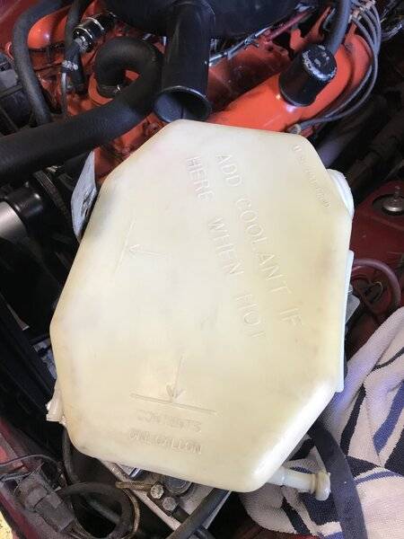

BillGrissom Well-Known Member Joined May 10, 2009 Messages 8,120 Reaction score 1,025 Location Sacramento Jun 26, 2020 #7 Looks like the plastic might still be OK. Few OE coolant tanks around since the plastic hardened and cracked from years of underhood heat.
