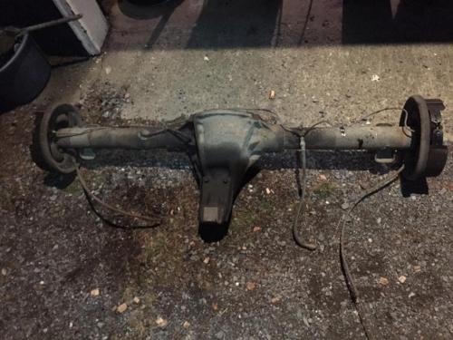

I got the old one out and the carrier/side bearings are for sure smaller so I'm going to measure and see if the older size bearings will fit on the new carrier and pinion and if so il just order new ones for the 74 rear and put them on the new carrier and pinion.
Well back to the drawing board and more research. The bearing sizes are bigger outside and inside on the new one so I need to figure out if there are bearings that are the same size on the outside as the old ones to fit in the races and bigger on the inside to fit the bigger shaft of the newer carrier.
Or just buy some different ring and pinion gears to fit the old open carrier for now.
There are two sizes of carrier brngs. Get the cone off the carrier shaft and measure that shaft OD. Record that and ID of case bore, then talk to good parts store for proper brng set. Dr Diff could answer your questions and supply bearings too.
Looking like I might have wasted my money on that stupid carrier and mine has 245s so I can't go any more on that one. Oh well live and learn.
after countless hours of searching the net it looks like there might be hope for me after all and it was right here lol go figure. while the carrier is a little different ( as far as clutch type)it looks like the rest could be the same.
So now i know i should be able to safely remove the ABS ring and the pinion bearing should be the same ( still need to get a micrometer and measure) now i just need to find out of the "right" size bearings are the ones like i have on original carrier so hoping i can get a good measurement with the bearings still on and if not ill pull one off.
http://www.forabodiesonly.com/mopar/showthread.php?t=205227
so pinion bearing is the same and the bearings off the old carrier will fit on the new one so i will buy all new bearings and seals and go from there. Im gonna take the rest of the rear end out so its easier to work on while setting it all up. will update as i go and add pics to my build thread.

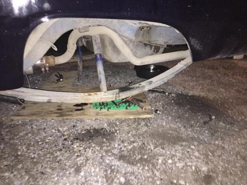

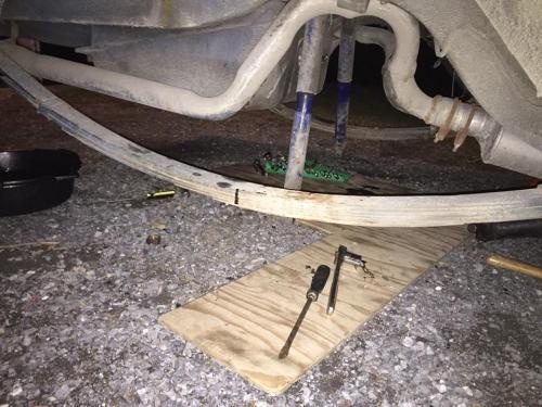

Well it's back together and seems to work just fine.Seeings the gear set was used we set it up for pretty much as close as possible to the same wear pattern that the set was already showing. It was late and dark out so I took it just for a short two mile drive and while I wanna dive it a little and recheck all the ubolts and what not.
Over all in the couple miles I drove it I'm super happy and it seems to have really woke up the sleeping beast from under the hood. Lol
