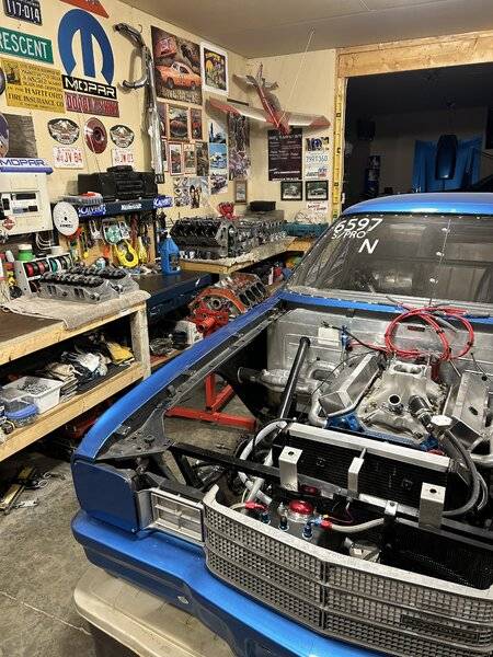

My garage is full of mopar awesomeness lol
355” W2
414” Aluminum A W8
416” R3 W9
Can you tell me more about the W8? I've always been intrigued by the alu small block.
Small Bullet roller cam, good compression, CFE tunnel ram with toilets, Fowler aluminum rods, dry sump. Very mild combo to be honest.

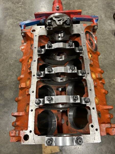

I’m about to finish up my 355 engine. I’ll have the 3.45 stroke crank in a 360 block with a Bill Richardsons bearing spacers to allow the small journal crank in a 360.
The 355” kit is a darn good piece. I’ve had it in 3 different blocks over the years

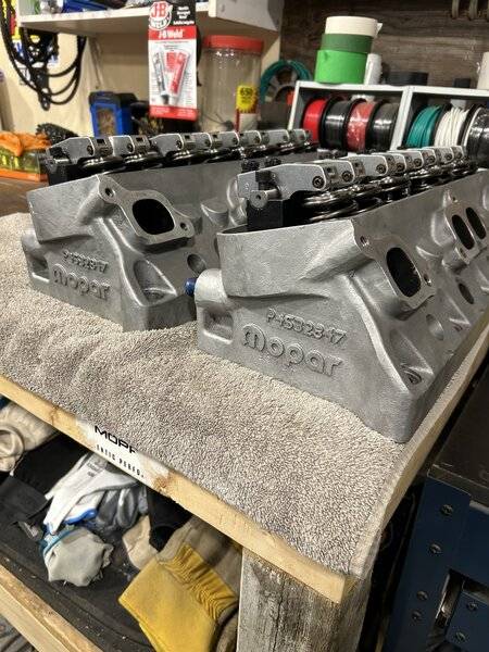

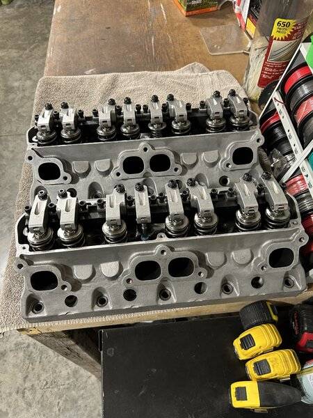

W9’s are lite compared to W8’s. Almost 6 lbs.

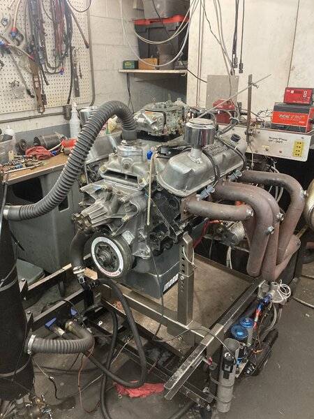

W9’s came in at 37.2
W8’s came in at 43
