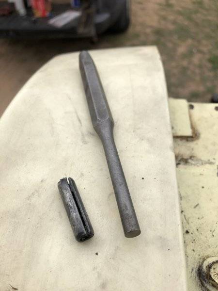

Got it out with no problem. Three medium taps with my mini sledge on the punch pictured and it shot right out.
Then used my pickle fork as a lever and gently pushed the spline off the coupler. It slid right off. Thanks 67 and the rest of you guys for the replies. Pics.....
