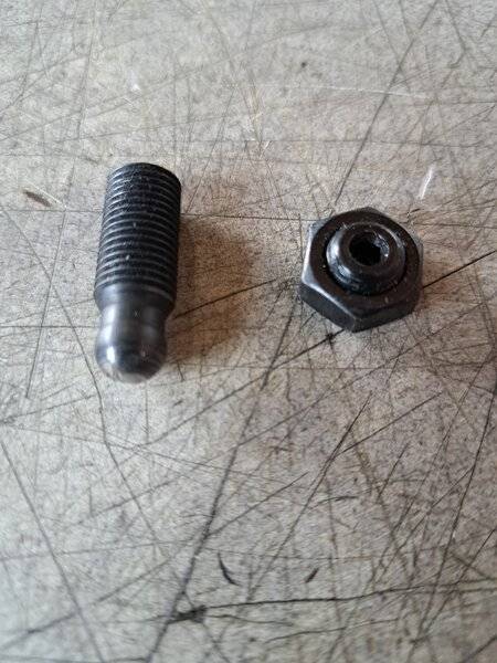

Bionic Chriss got on it, now he needs a new one. Crane #99802 is obsolete, 3/8-24NF w 5/16 ball, Brad Anderson Ent. shows a BA13RS. Are there any other choices?

When I pulled the golds off my 360 (motor came to me already put together), I found 3 that looked like this. Pretty sure I got my new ones from Smith Bros, along with the new pushrods.

The ones I got were just a tad different from the originals. Photo is (L-R) MP 273 replacements, Smith Bros, and the ones from the Crane rockers.
I broke a few right away.
My push rods were measured and custom made. Geometry was right. So I conversation with Crane.
Guy asks were they Black or Gray?
Oh damm we normally make them our selves, and ours are gray. We outsourced and those were all bad. Told me don't use any more black of the ones, they are bad.
And I could not get replacement push rods either as they also out sources the tips and were out off them too.
Thanks to cheap overseas crap.
Can't blame them, trying to compete price wise quality went down and so did the company.
