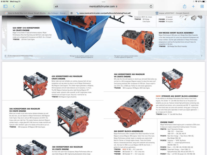

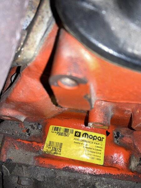

Anyone have one of the magnum crate motors with an 8 quart pan? Doing an Oil change on the 402 mopar P5007647 and the stick is reading full with only 6 quarts in. I have mopar 3870265 dipstick which shows is for 1976-1982 318/360 for a multitude of different body styles.
‘everything I read about the motor says 8 quart pan and it sure looks like it to me.

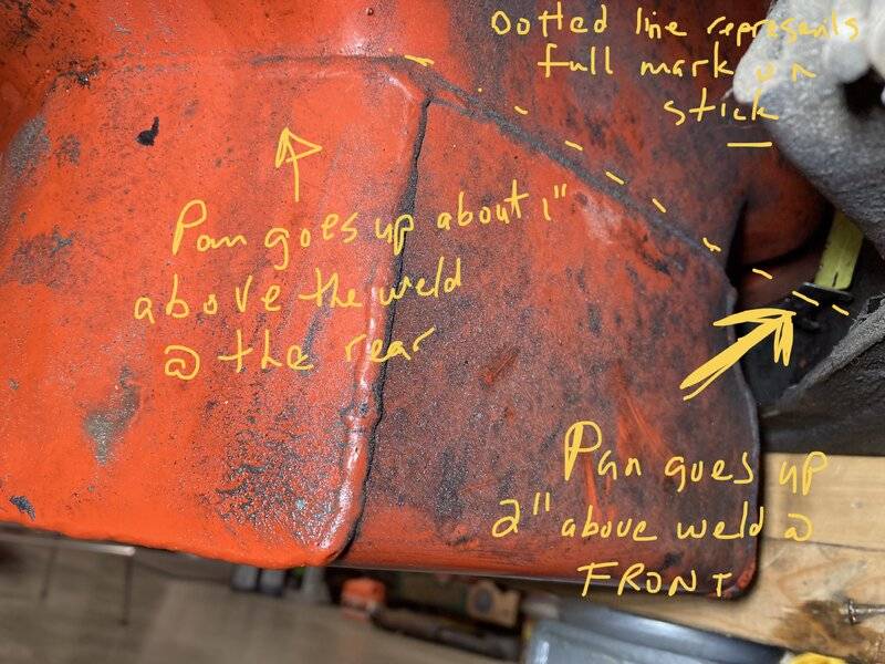

I measured the tube length and then from where the dipstick is fully seated to the full mark. Then measured to where the dipstick full mark should be (approximately) on the out side of the pan. It’s at the weld mark and it appears that I should have room for at least another quart. I think mopar used Milodon pans for these But I’m really not sure about that.
the tube measures close to 9.75” out of the motor, the full mark measure 19.5” down from the seated position. Therefore the stick full mark is resting about 9.75” below the tube. I’ve attached a few pics which show that this would put the full mark right around the weld on the pan. Looks to me like I should have room for another quart or two?
attached a few links describing motor, dipstick.
motor
402 MP crate motor pistons?

Just thought about it and I think I’ll measure the pan and calculate just the volume of the sump and decide from there
Never in my life seen a sump like that on a 6 quart. Did you see the picture?
6qts is TWO more than stock. Keep that in mind. Also, it does not matter that the pan is stock depth or TEEN FEET deep. If the dipstick is accurate with a stock pan it will be accurate with any of them.

I agree, but what I’m not sure of is if the dipstick tube belongs with my dipstick. The whole car is new to me and I’ve been spending time unraveling and correcting a few mysteries, this is one of them. It always takes a while to sort out cars when you buy them.
I will start and run with 6 and see how it goes. From what I’ve measure and how it appears I think I have room for another quart with zero chance of windage from the level being too high…

I get all that in regards to less windage, more HP et al’ but I’m starting to think that they (previous owner) cut the tube down to make it look full at 6quarts in the pan when the filter is full. From measuring and looking at all this I think I have room for another quart and the oil will still be well below any potential windage issues and essentially at or below the baffles in the pan. I see and appreciate your post‘s on the other thread too. From Bob and now yours I’m thinking the tube is too short. Waiting for Bob’s other measurements when he gets a chance too.

As in the other thread you’re thinking about it backwards. My tube is already too short causing it to read full when there’s room for another quart for sure.
