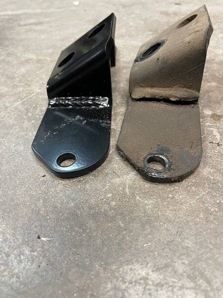

So after my 410 small block has proved too much for rubber mounts and TQ strap on my 72 demon. I’m looking for some better mounts for both the motor and 4 speed trans mount. What is currently considered the best choice? Pic below of the weld ripped off my TQ strap bracket. I have replaced the TQ strap bracket in the mean time till I can install some new mounts.
Ditto. The issue is the crap weld on the old brkt. Welds on the new brkt look very good.

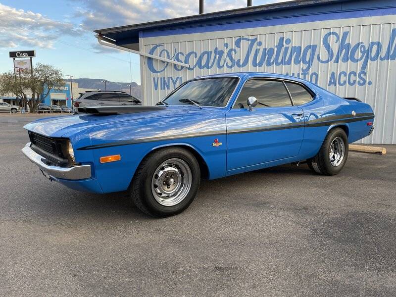

That Demon looks really sharp!! Would you mind sharing the real wheel specs? 15x10? Backspace please!
The fronts are 15x7's and the rears are 15x10's the rear tires are 295/55r15 MT SS Drag Radials. I bought the wheels 8 years ago I can't remember the back spacing but I can look around and try to figure it out for you. What ever it is they work perfect with those tires. Im running Caltracs mono leafs in the stock location with caltracs bars. The tire has about 1/4" clearance with the spring.
