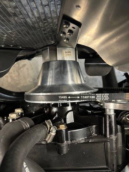

I don’t have power steering but ended up running a Duralast 15465 belt for my setup. I also have the aftermarket alternator adjust to clear the aftermarket heads and man you can get a good belt tension with that kit. Well worth the $100 or whatever I spelt.
Here some pics
