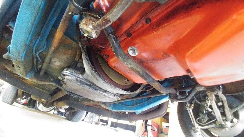

Darn oil pan
Have you checked the transmission mount? Make sure it’s not crushed and worn out?
yes, i replaced it because it was pretty rough. I am 'kinda' sure it didnt do this when i first put it together, but its been so long i wont swear on that. Years ago when i put the stock 440 in it with a pan that wasnt notched at all, the centerlink banged the pan all to hell, so when i put together the engine in it now, i got the 187 pan and i swear i remember checking it out after i got it all together and it didnt touch it because i remember thinking what a relief, but i dont know what the heck could have changed that much
I installed the oil pan that is recommended for an A body big block swap and noticed the idler/draglink STILL hits the pan in another spot other than where the pan has the notched dimple..Is anyone else having that problem?
View attachment 1715663233 View attachment 1715663234

I'll see if I still have that tomorrow......
......i dont know what the heck could have changed that much

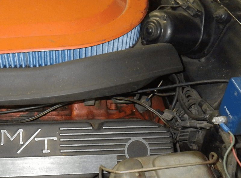

FWIW, my passenger side valve cover is about 1-1/2" off the firewall.....
As you can see the driver side is not going back any further.......

Center of crankshaft to top of K frame needs to be 5 1/4"
Center of crankshaft to framerails needs to be offset towards passenger side 2 1/2"
Then make sure your valve covers are plumb to framerails.
That's your factory starting point.
ok, out here measuring it, the back of the passenger side valve cover is 1 7/8 from the firewall and the driver side is 2 3/4. The offset from the center of crank to passenger side is 3" and the distance between the center of crank to top of K-member is about 5 1/4
That area is a problem on every cars with the early center link. Put one 3 lb. sledge against the pan and hit it with another 3 lb...
