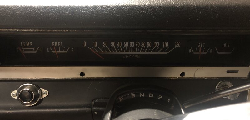

what could have caused this all of a sudden? i do not know what the interior specialist did or didnt touch. could it be something was reinstalled backwards on the headlight switch? my dashboard type is shown below.
Anyone have any ideas? thanks in advance!
