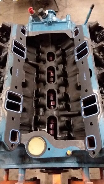

Here is what 318 (small port) intake manifold gaskets look like on 360 stock heads.
318 intake gaskets too small for the 340/360 heads.
