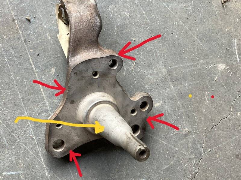

Hello, I have a problem with this disc brake conversion kit I purchased on eBay. I thought I could just drill out the lower ball joints to make them fit. However, the bolt pattern on the new spindles is 4.5 inches, while on the ball joints it’s only about 3.85 inches. Which lower ball joints do I need to order to fit my spindles?
First, there are proper terms to use.
The red arrows point to the steering knuckle.
The yellow arrow points to the actual spindle.
If you have steering knuckles like these, you need the 1973-76 A body disc brake lower ball joints. The B and E bodies use the same ones.

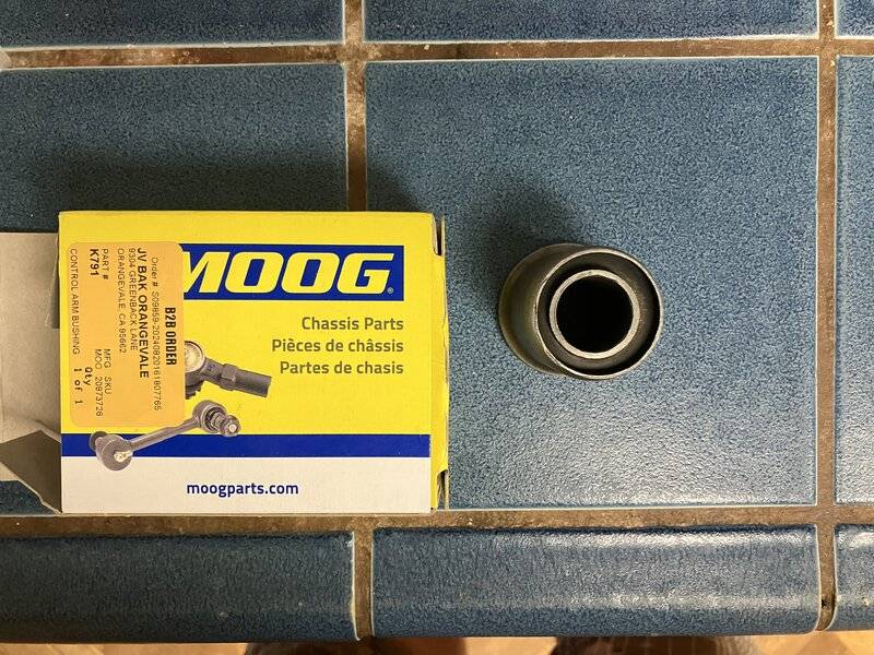

Moog used to be the best. Nowadays, they are sometimes good, sometimes crap.
Take a look at this lower control arm bushing:
Yeah...that bushing is off center. GREAT quality there, guys.

Hey, I wasn't criticizing your use of English, you write fine from what I can tell. Most people refer to the unit as a "spindle" but it isn't the correct term. It's just like calling a limited slip differential a Posi when the correct term for Mopars is Sure Grip.
Get ball joints for a 1974 duster.

Moog k-781, k-783

The upgraded 10" drum knuckles that started around November of the '73 production used the same lower ball joints as the disks. Not sure what happened from August to November with the drums but I don't see a reason to restart that discussion because the parts references used by most places won't deal with it anyway. If you look up a '74 Dart or Duster it only shows one style of lower ball joint (the later disk style) and does not specify disk or drum.

Yes, all '73-6 A-bodies use the same upper and lower ball joint regardless of which brakes it has.
