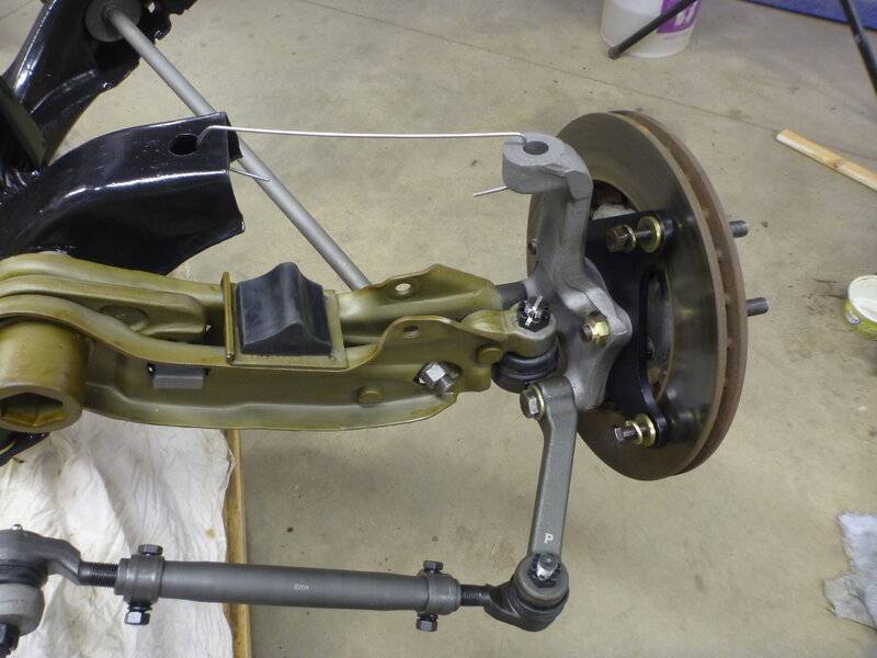

..and aftermarket stuff is important to torque. This was Wilwood's hardware that didn't make it anywhere near spec and I replaced with some aircraft AN hardware..
