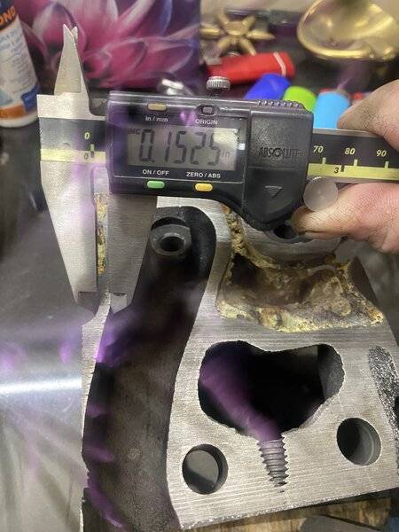

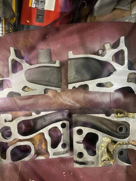

Hey guys so tonight I cut up an old 675 cylinder head, I’m currently doing some porting and really wanted to know what the general boundaries were. If anyone else out there wanted to know or wants any specific pic or measurements please let me know. Cheers
Thanks for sharing. Makes me realize how close I've gotten to a water jacket on some of my earlier home port jobs!
No problem. If it helps just one person I’m happy. Again if you or anyone want better or different pics I’ll do my best to get them quick. Tonight I’m gonna clean them up and take the calliper a to a few spots for myself. So just let me know.
