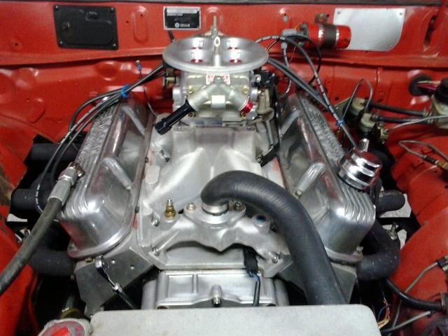

Hey 19Duster72,I like your D-50. I have one too, but mine is a pump gas 394 stroked 340.I built my own headers, they are fenderwell. I started out with block huggers on mine,they were too restrictive.

Nice looking Fab work,and welds. I would pop,for the custom made ones.(If the coin,is available).
My D-50 has a pump gas small block,best ET so far is 1.34 60ft.,6.34 @ 108 mph. Her is engine bay shot. Probably not as full as the big block one.
