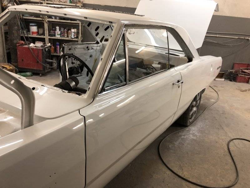

hi! I have 2dr Dodge Dart 1968, and couple months before I’ve bought the wrong rubber, somehow it’s bigger and the whole process is stuck!!!
“1968-1976 DODGE DART PLYMOUTH VALIANT 2/4 DR SEDAN WINDSHIELD RUBBER SEAL IN STK” this is the discription from the seller, who made mistake and how to get the new one in a urgent way? I’m month away from US :(

No it is not, you have a 2dr hardtop. The 2dr sedan has a post in the middle between the roof and the door like a 4dr car. The ht models have a lower windshield than the 2dr/4dr sedan.
It may be an optical illusion but I would measure the window opening (top to bottom) and the glass to be sure the two are correct for each other. the glass in your photos looks not as tall as the window opening in your dart. (disregarding the incorrect rubber seal in the photo)
Obviously if you took the glass out and it fit correctly to begin with you can disregard my suggestion
(good looking Dart by the way)
Find a vendor who sells the Precision brand of windshield gaskets. You will need a WCRD 690 for the 68 to 76 A-Body Hardtop windshield gasket. Should be around $90 to $95 depending upon the vendor. Have sold hundreds of them with no issues.

You should be able to resell the unused 2-4 door sedan gasket on FABO if you cannot return it for a refund. Lots of members here have the 4 door sedans. Sedan gasket on those with the taller windshield goes from 1968-1976.
