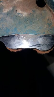

The thing with A & B-body lower hinges is that about 75% of the hinges sent in for remanufacture are stress cracked in the lower door spring areas.
