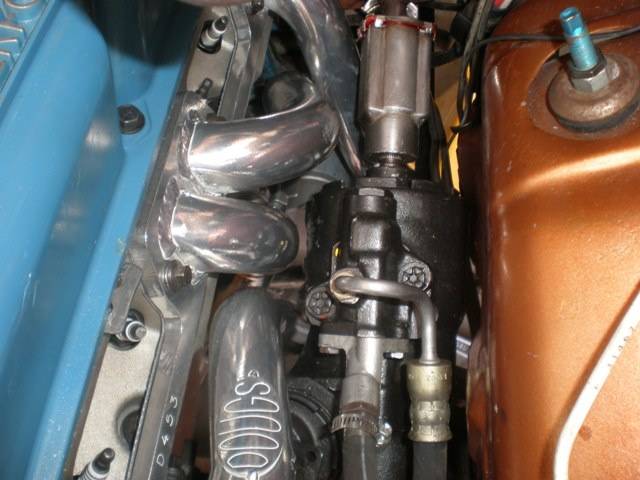

I just finished installing the Doug's D-453's on my '74 Duster w/ power steering and a stock type Milodon Pan. Fit is awesome. Wish I would have known about these the other two times I put headers on this car!
I think something is wrong with those headers, you shouldn't be able to get
to the spark plugs that easy lol.
