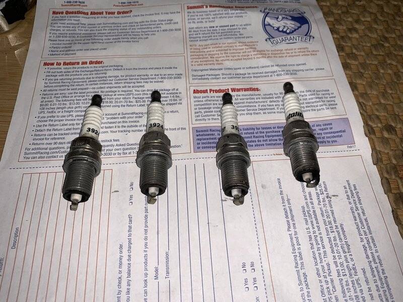

I pulled the left side plugs, noticed that plug 7 was not connected, just loosely sitting there???? Not sure why. Picture is plug 1,3,5,7 right to left. I will be welding the O2 bung before anything else. I will also get the 8 am hose to complete the connection to the efi and eliminate the -6an restriction
You my need to clean your o2 sensors while there out, for bung welding.
