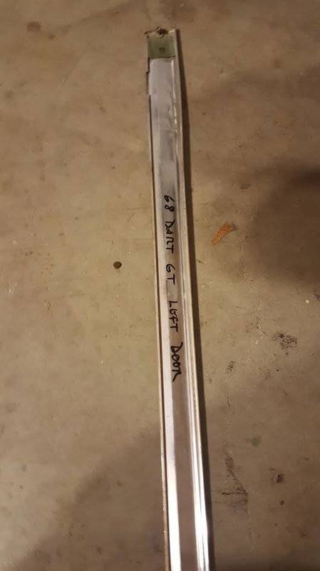

So, when I bought my '68 Dart GT, it never had the driver's door trim on it and it was nowhere to be found. I later found out that the door was from a '69 or newer car because the lock was farther forward than the '68 door on the other side. Well, over the years I've acquired the '68 Dart GT driver door trim and now that the car is home, running, and driving... it's really starting to bug me that it's not installed.

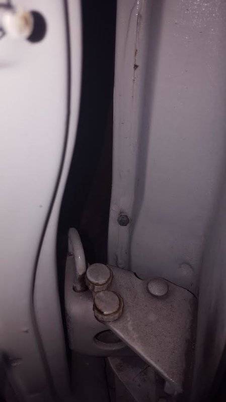

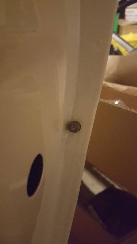

Looking at my piece of trim and the passenger door, it seems like the only thing that holds this piece of trim onto the door is 2 nuts. I don't see any provisions for clips in the center. Is it really this easy?
I also have to drill holes into the new door. I really don't want to take it off for fear it won't fit when I put it back on (just my luck). Any tips for drilling holes into the door? Should I drill from the outside going in or vice versa? Should I lie down a layer of painter's tape down before drilling?

I bet there should be a couple of push in type clips between the two outers with the nuts. Even my wagon's door/fender/quarter panel trim is like that.
yes, from the outside in, don't lean into it, let the bit do the work. YES, blue painters tape - two layers on the outside. Also, go buy a set of drill bit stops.
There should be a handful of holes along the length of the door also with push in clips that go into the door skin like Dartman said. Good luck with your install.
Yeah, I found out there are about 5, rectangular plastic clips that go along the trim. I might just send the car to the body shop my dad uses sometime next year and have them do it. I have an anxiety thing about drilling holes as they're (semi) permanent. 2 holes would have been ok, but 7 starts to freak me out in my mind.
