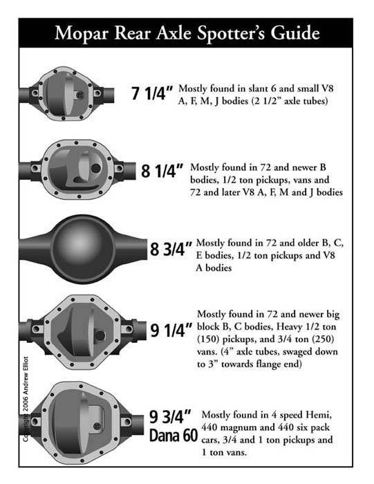

is it a posi unit....make sure it is in neutral..what rear end..here is a pic..Iknow if it is a posi and it has been sitting awhile it will stick together...The clutches and plates
Oh sorry...8 3/4 posi...it has an aftermarket ratchet shifter as well..wondering ifit could be an improper install.
