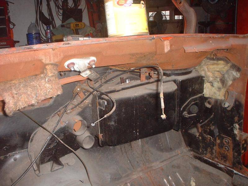

What has to be removed to install firewall insulation on the driver-side..?
72 Demon
When I was under dash of my 67
to pull the gauge cluster it seemed like there was ample room on the drivers side to access the firewall.
vent box, park brake and brake peddle assembly. Unless you slice things to slip over the cable and behind the box.. I have seen them put in in pieces but it is so much easier and a nicer job to just take it apart and paint behind everything first
I agree aboout removing everything there is a section that i used spray adhesive to glue the insulation on. I do beleive the factory did it the same way on the underside of the cowl.
