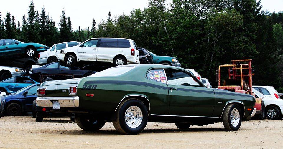

Hi , does anyone is running with 15X8 inch wheels on the front . Right now i run with centerline convopro 15X4 in the front (mickey Thompson 26inch tire) and 15X8 on the back (275-60-15) . I have 2 others centerline 15X8 that i will like to put in the front with 215-70r15 rubber . Does it will fit the front ?

My backspace is 4 1/2 '' on those 15 X 8 wheels

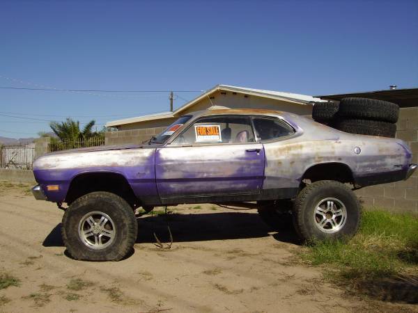

No, it's not. With a 245/60/15 on the front like you suggest that tire will stick out past the lip of the fender. Not to mention that's a 26.6" tall tire, where anything much taller 26" causes clearance issues when turning. I suppose if you run it jacked up like a 4x4 it might clear. But at that point you should just sling a dana 44 under the front and go wheeling like this guy...
Yeah, sure, I'm being dramatic. But you're going to need a couple of inches of air space between the tops of those tires and the fender lips if you don't want them to ever intersect (rub). And that will put the front way up in the air, it will sit up as high as the back does. And that's not a good look, even if you're a fan of the big 70's musclecar rake.
