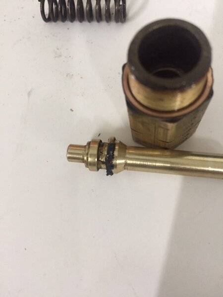

My first job on my newly installed hoist was removing this valve. Was still a pain in the *** because of headers but a lot easier than lying on floor. Anyway after stripping the combo valve this is the damage i discovered on one of the pistons/valve?. It is butchered and obviously it has been jamming in the bore. Can you buy the replacement parts for these or is it a new Combo Valve. I had bought a seal kit from Muscle Car Research but didn't expect to find this.

Have you tried to clean it up (brass wire wheel)
That looks like the desolved remnants of a seal / O ring.
Granted some of it was however the brass is damaged and knurled over one one spot. I did have to apply heat when removing some of the flare fittings and maybe I contributed to its demise but nothing else in the unit is damaged.
They are simple devices, I would chuck the spindle in a drill motor and take some 220 or so sand paper the the damaged spots. You don't have much to lose at this point.
