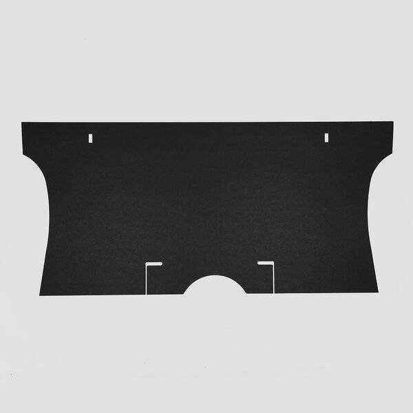

my Duster has a fold down rear seat and it was missing the divider board. I bought one from Detroit Muscle Tech. Does anyone have a photo they can share that will show it installed? I can't get my head wrapped around how it show be positioned. Thanks in advance.
This thing?
If you've got a fold down seat car it wasn't "missing" the divider board. It never had one. Kinda defeats the purpose of having a fold down rear seat.

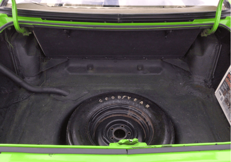

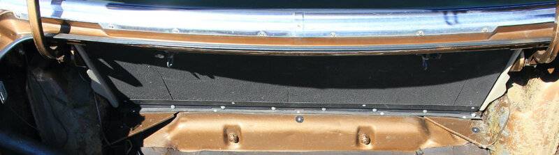

On a standard rear seat car the board hangs off the seat hooks and rests on the cross brace, you can see it here from the back
Where it would be from the front, with the slots hanging on those hooks
