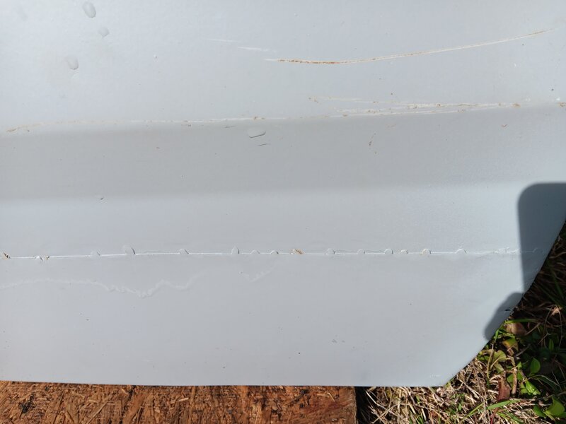

I have some extra windows and doors that came with a 74 Duster I bought and have been working on. The green doors on the car have for lack of a better description have the 4 mounting points and rollers. The hardware shown looks like it matches the window with 5 mounting points. I'm thinking that the 5 point primered door is actually for 74 cars? They came on the car unassembled, with 5 point windows and hardware pictured in the trunk.
The green doors with the 4 points came assembled with the car. I swapped them with the primered doors which some one started to repair on the bottom. The 4 point roller hardware is not in good shape on 1 window and the other side the rollers are completely missing. It looks like the 5 point windows and hardware which, other then a good cleaning is complete in good shape and looks like it will work on either door? I personally prefer the 5 point setup. Which is correct?

I got it figured out and working correctly. The green doors are 73, primered are 74. The 74 doors, have all the major parts, but a few harder to find pieces are missing. The past few days, I've been working on the green doors and with some elbow grease, was able to get them in good working order, as the car came with an extra 73 window which had the damaged part that I actually needed.
Now I have essentially a complete set of 74 doors that are missing, the passenger outside handle, locks, as well as a couple couple of the small rods and clips to operate them.
