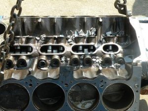

This combo does not exist any more, it did not like the Nos

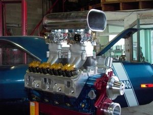

was a 360 block KB piston 30 over 10,7/1 eagle rods, stock crank (Cast) Edy heads out of the box, comp cam solid flat tapid 555 lift Weind dual tunnel ram with 2 AFB comp ser carbs.

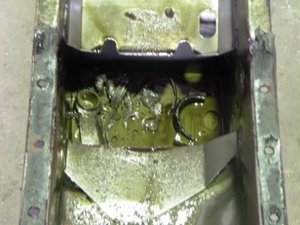

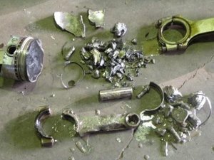

four years later I added the nos, this is after 4 passes with a 180 shot of nos
ouch maybe dident like 180 haha maybe 100 but that was a beast
New combo is a R3 block bord 4070 4" strock 416 cubs Crank is a scat pro comp drag crank Same eagle rods with the 2000 ARP upgrade, Diamond pistons 11.7/1 custom grind bullet cam solid roller 710 lift, Indy heads fully poeted TD rockers Indy 360-3R race intake also ported and blended, no carb yet working on my Tub front clip.
Expecting 650+ HP on engine and still the Nos, not sure if Im going to need it.

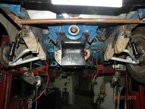

This is the first stages of the front end. long way to go yet.

Did you ever pinpoint the failure? I see you went with eagle rods again, which I've heard good and bad about. I'm considering Eagle 7.100" so wondering what you think.

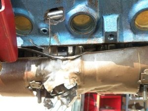

Isn't the nitrous fault for that one is my guess.
So I been told the KB pistons shader into peices with Nos, this eng had not mist a beat prier. I have a lot of diff shots that you may make up a diff story than I, I jues there are many poss Ideas. here's a few more pics, this happened at the track shiftting from first to sec at 7500 rpm with the Nos. ?:read2:
The rods are grate, it the bolts that fail you need to up grade the bolts to the ARP 2000s they are said to be able to handle 1000 hp that was straight from scat that asured me. If you look a the pics in this thread you can see a bolt had broken as well, just dont no what broke first the piston or rod bolt, I was over the rec HP for these blocks could have twisted the block took out a bearing and then the rod (6 or a half dosen ) the combos are endless.
