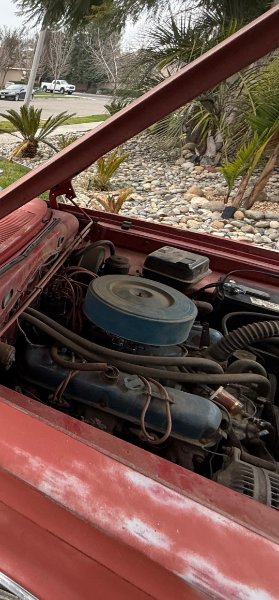

On the 65 Barracuda 273/2 barrel built Mar 65 that I had, there was no bracket for the heater hose next to the PCV tube
Early covers with a hose bracket. interesting. They apparently changed the hose routing mid year. THey started with them and found a better way. (or cheaper)
My 65 ( built Dec 4, 1964 ) had hoses mounted on the inner fender and not across the valve cover.
By '66, the heater hoses were not attached to anything. They were bound together and just floated with a aluminum strapped chunk of heater hose for protection against chafing.
