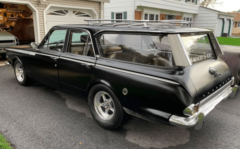

Has anyone got a nice roof rack, center trim, and what's left of the rubber strips for sale ? I want a rack for my 65 Valiant wagon.
I WISH I could find one. I'd cut one down and mount it on Vixen's roof in a minute. I think it'd look super cool.
It would be super easy to cut on down - leave the F & R parts as is and just shorten the outside poles to whatever length you want the rack to be on the roof.
I say install it!!!

I Agree 100% . The roof rack is icing on the cake on Valiant wagons ! Again, if anyone wants to sell one, I will pay.
Right! I just gotta find one. LOL
