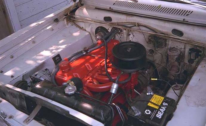

so I'm looking online at pics of original and restored engine compartments of 1962 and 1963 A body cars and it seems none of them had a windshield washer set up.
Is this common knowledge amongst early A owners or am I not seeing it
If you look above the clean out plugs and hood to cowl seal on the 3rd and 4th pics, you’ll see a little opening on the vertical part of the cowl. That’s where the washer nozzel would be located. On 60-62 IDK.

Not sure about 62, but windshield washers were optional in 63. As noted above, unlike later A's with a plastic tank, 63s and 64s used a bag hung on the driver's side inner fender next to the firewall. This picture from April 1963 Motor Trend shows it, but it's partially hidden behind the guy's arm.
