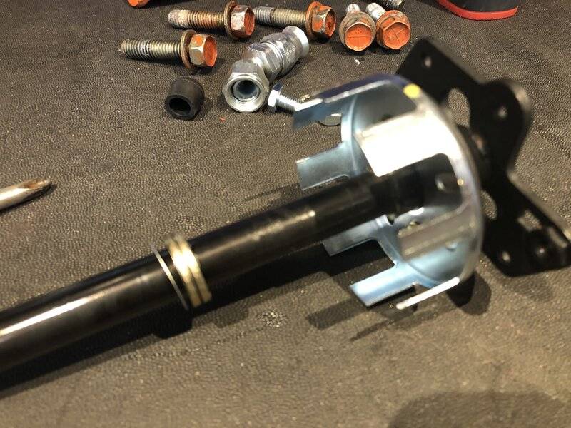

Next issue for A body guys which I’m sure isn’t their intended market is the distributor is too tall. I disassembled mine and shortened the lower housing and the shaft. We broached the shaft and ran the lower housing in the latch. You couldn’t tell it was modified but it’s 3/4” shorter now.

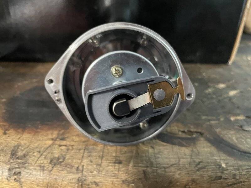

Last and largest issue is timing. Once the timing is synched and the curve was set, I immediately noticed something was wrong. I set my normal curve 20 initial / 30 total. The total timing was determined on the dyno before installing the engine. No power and popping through the exhaust. Some other mopar guys had the same issue. After thinking about it I figured out the rotor is out of phase. Meaning the synch of the spark and injection is off. Advancing the timing puts the rotor too far away from its respective terminal causing the issue. I wound up slotting the reluctor to align the rotor with number one terminal at the middle of the timing sweep. Bottom line is, it was free and it fixed the issue. Starts and runs great, tons of torque. Why can’t a huge company like Edelbrock get it right?

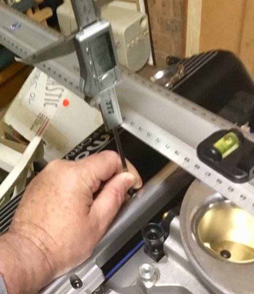

Would this fit under a stock flat Barracuda hood?
I really REALLY want this but it's gotta fit under my hood...!

For those that wish to compare the relative height difference between their existing combo and the ProFlo4 this photo shows the vertical height measurement from the top of a cast rocker cover rail to the very top of the throttle body - 6.340” (apologies for the poor focus)
What does the distributor hit? Windshield wiper motor?

Resurrecting an old thread. After Edelbrock locked my thread about the phasing issue last year...I receive a new distributor from a customer to shorten for an A body. Guess what, they changed the shaft to accept a Ford rotor. What a coincidence!!
