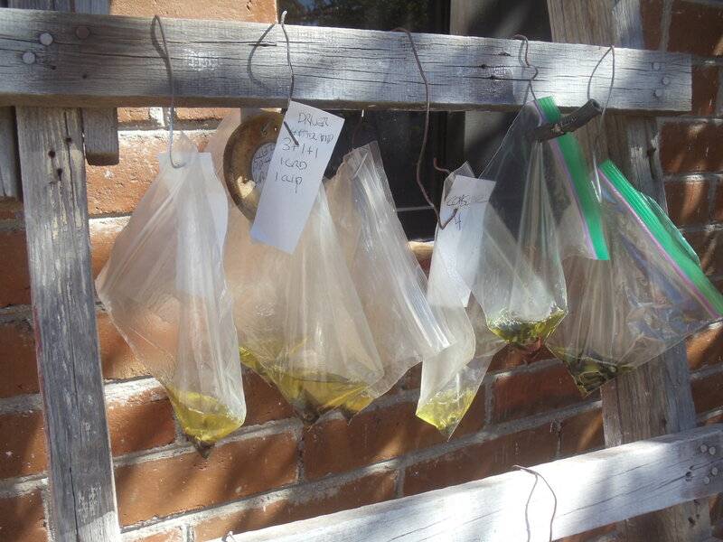

Found a way to clean factory fasteners and keep track of where they belong. Hang each stored "baggie" of fasteners on a wire, pour in Evaporust to cover, hook the ID tag/note on the hook with the corresponding baggie. Repeat with each labeled baggie.
