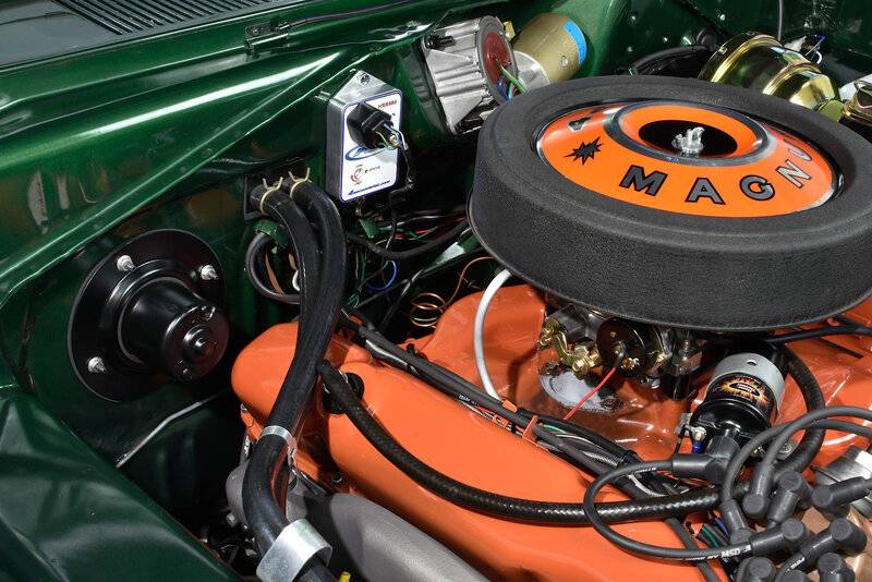

FBO's black HEI ignition box
moparlee
64 Valiant
Aug 18, 2004
1,558
101
Joplin, Mo
How many bought it before the white one's came out?
The MSD HEI module # 83647 is better, switches 7.5 amp & has a rev limiter. Stock HEI modules switch about 5.5 amp.
Went through a bunch of modules at least three not counting the one in this picture in this....I'm actually going to let this one go with that new module I just got from you.
4 pin moduales? They usually last a long time. If you ever want to sell that black ecu box I would be interested. Easier to run/test module that way for rpm failure, my tetronix tester dos not do that.
Never even heard of these FBO boxes until this weekend, here. Thats one of the reasons I like this site. Even old coots like me can learn new stuff.
@Stephen Hotz will be making the ecu boxes with four pin moduales in them soon. Definitely needed.

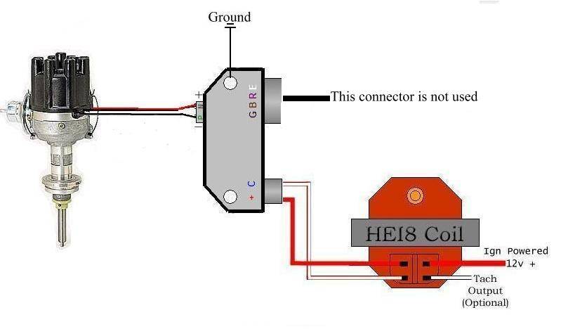

I have been running an 8 pin GM module with the HEI8 coil off my OE style distributor for over 7 years.
Had to change it out once because of a top end miss.
I keep an extra one in my small tool box in the trunk.
The 8 pin module and HEI8 coils use weatherpak rubber sealed connectors unlike the Ford units that have exposed blade style terminals.
These 8 pin modules also have an ignition retard function that allowed the computer to deal with detonation via the module by applying 5v to one of the terminals in the unused socket, though I have never personally used that feature.
They also still fire with lower voltages than the 4 pin module. (Like a low battery scenario)
There are quite a few guys on this site running these that bought the ready to install kits from me, and I have also built these into the OE Mopar ignition boxes.
Is that on the black boxes or the new ones? I’ve got one of the new ones waiting to go in the swinger for a 383 that I plan to rev.
I‘m not sure which box he was talking about when he said it doesn’t retard with RPM.
Like I said, they ALL retard with RPM. How much and when it starts are variables.
Thats why you need to test for it.
