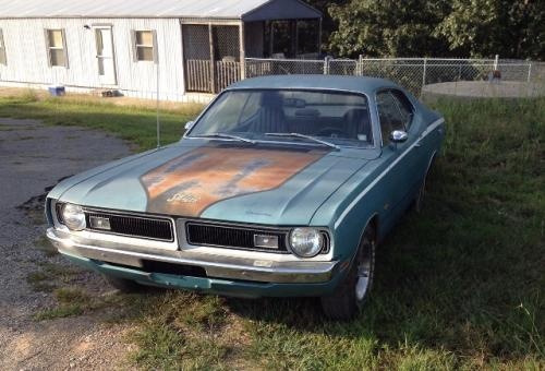

It's been a loooong time coming, but she finally moves under her own power. I can't drive very far because the 4 mismatched tires that I rounded up to be able to move it are in very bad shape. So, I need new tires obviously, but I also need to replace the rear axles since currently it has BBP in the front and SBP in the rear. So, my options as I see them - Run mismatched wheels and try to find some cheap used tires for the time being. Go ahead and swap the axles out, and get some good tires to run with the new wheels I will buy. When I do buy new wheels, I was thinking of going 15s instead of 14s. Thoughts about that? I will be running rallye wheels. I have replaced the front drums with a later a body disc setup. Thoughts? Oh, its great to be back! :thumleft:

Dr. Diff on the axles. Put new tires and wheels on it, 9 years in getting it running is alot of time and money vs using old junk tires and wrecking the car.
Run factory 15 X 7 with 4.25" back space.
Aftermarket reproduction ones only have 4" back space.
This will allow you to put a 275/60/15 on the rear and a 215/65/15 on the front with no rub issues if your suspension is in good shape.
Is that a sizzler?
Looks solid go with 15" because 14" tires are about obsolete.
Good luck

It is a sizzler and very solid. I know itwill upset some but I am going with the dual scoop hood instead. It must havehad a strange history because someone painted the car whatever color this isand added the non-factory stripe. It was originally B7 blue. I plan to paint itthat or maybe B5.
I was thinking the same as you on the 14”vs 15” wheels. I found some online fairly reasonable and could run 15x7 on thefront and 15x8 on the rear. The 15x7 has a 4.25” back space and the 15x8 is 4.5”back space.
I would really look at 15 x 7 for the rear.
15 x 8 are real close to the 1/4 panel.
What engine in the old gal?
Also how does it drive?
I have 15x8 on the back of my stock Demon with 255/60/15 tires. Not even close to rubbing. Fronts are 15x6.
It has a 360 right now. Was a /6 originally. Hopefully a 340 someday...
How does it drive? I'm just thrilled it moves for now ha. Seriously though I've only had it on very short trips so far. The mismatched tires/wheels make her bounce even at low speeds. At least I hope that's all it is.
