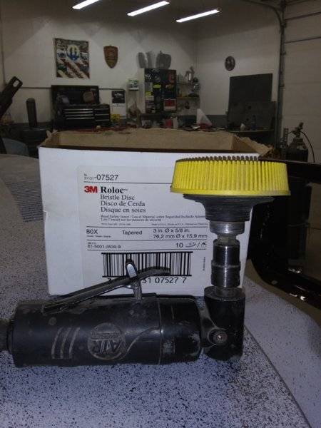

My gasket scraper the yellow works great on aluminum they make a green disc that is more abrasive for steel.

Be careful with those Roloc discs as they take off metal...

View attachment 1715320007 My gasket scraper the yellow works great on aluminum they make a green disc that is more abrasive for steel.
Hard lesson.
I thought the green disks were going to be a great way to remove gasket residue.

Never had a problem with the Roloc but you need to keep the rpm down and and hold the tool steady or your right metal will fly.
