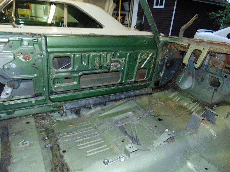

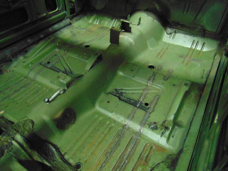

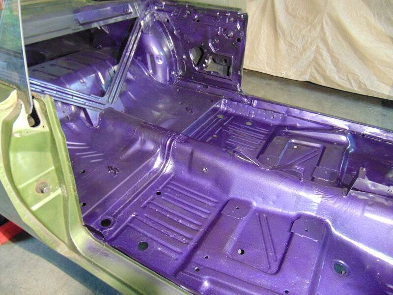

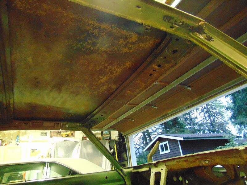

Before work got started I stripped all of the interior shell and painted it with epoxy primer and Plum Crazy single stage paint from 66 Auto Color. These cans have an separate interior cartridge of hardeners which you mix into the paint before use. I used this on the entire interior shell, the trunk and the engine compartment before sending the shell off to the paint shop. The materials ain't cheap, but it saved me a bunch over having the body shop do all that.
So here are pics from start to finish (requires multiple posts)
Interior stripping and painting
