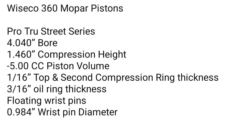

Found a set of used Wiseco stroker pistons for a decent deal and trying really hard not to crawl down that rabbit hole.
In all honesty I'd just like to find a of std bore flat tops someone upgraded from. I the pickings are too slim, I see some KB107's or SP H116CP's. I just need to keep the voices in my head quiet... :)
