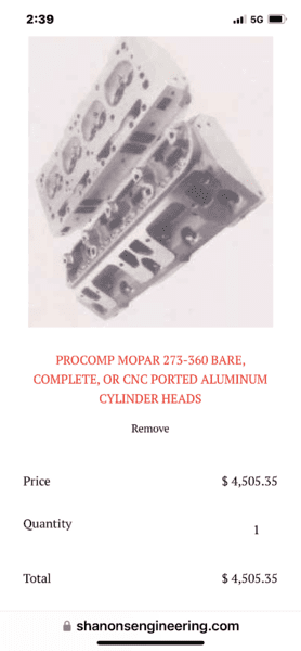

Who in their right mind still
Uses the “Pro Comp” branded name. That the name that has had people running away for years. I had to Google it and found this. I had to give myself CPR.
