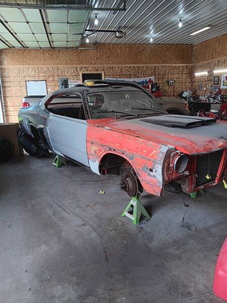

1972 340 Demon 4speed car, no frills, no tilt column. Bought the car in ruff shape, went from this to now. Never drove it, but getting close to
