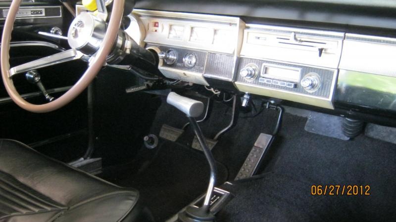

oldmanRick ....This 273hp Runs very STRONG !:burnout::burnout::burnout::burnout:
yeah the 273 goes well , my mother had a 68 GT convertable with the 273 4 bbl , I used to get her pissed off so she would floor the car , did superb burn outs !. It was much stronger than the 1970 318 she replaced it with , a much snappier engine , sounded better as well .
And really like your car dash looks great . So many cars , never enouh time or money !

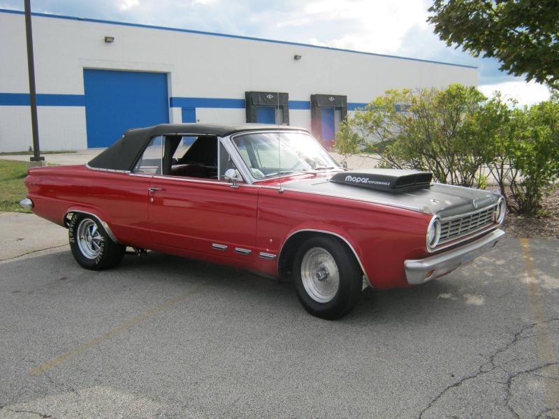

My stroker 65 dart rag rides real nice .. it has a mopar sm 402 crate magnum engine .. runs low 11's 1/4 mile.
It a hand full !!!
stays straight as an arrow when I get on her .
I don't see any down faults on this early dart..
you can even get a larger tire up in that rear wheel house.. with out altering .
