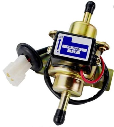

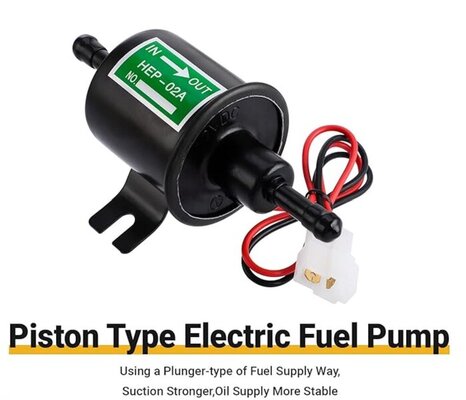

If I install a fuel pump like this one (2.5 - 4 psi) :
Or like this one (3 - 5 psi) :
do I also need to install a pressure regulator?
Thanks
Thanks
It probably doesn't need a regulator but it would be a good idea to check the pressure regardless. That is a piston typ pump. THey are a suction type pump so you mount it up front. It also won't work properly with a mechanical pump. Are you thinking about using it as a replacement for your mechanical pump? Or, you wanting to use it as a primer pump for hard starts? If so it's not for that.
Hi
I think to use it as a replacement for my mech pump, yes.
So, a regulator would be a security to check a correct pressure? Not really needed, but recommended?
You will need to find out how much fuel that pump will deliver. Looks like it is for a small 4 cyl engine.
Best pump you can buy is the Carter #4070, perfect for the job, no reg needed.
Thanks Bewy

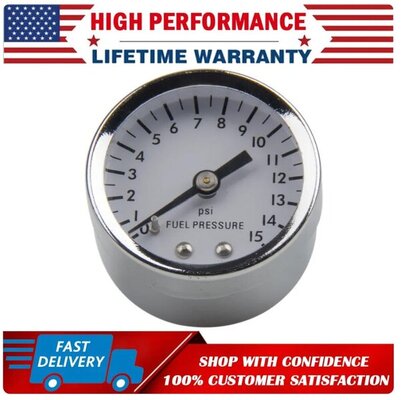

I will try the cheap EP-500 pump shown above because it's already ordered. I also ordered a PSI gauge to check the delivered pressure
