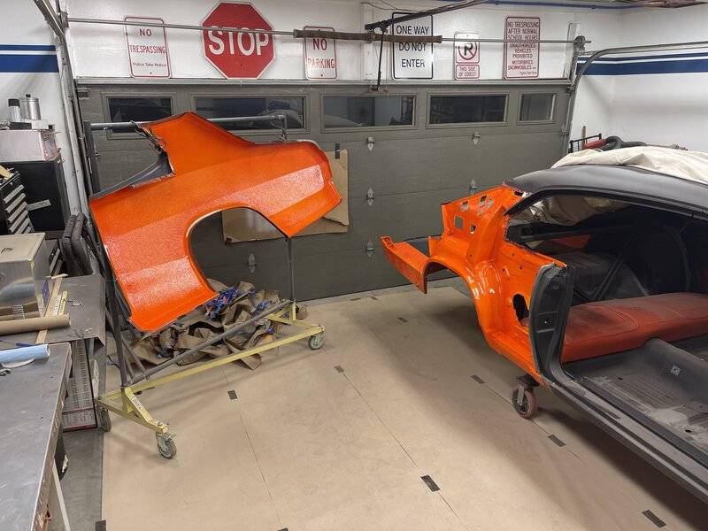

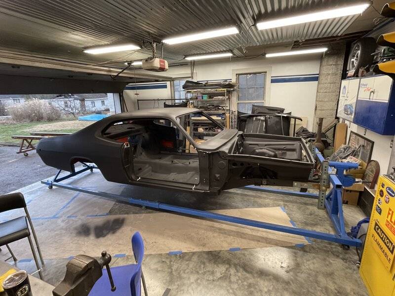

The Demon finally came back for floors, trunk floor, Extensions, wheel houses, and quarters . Here are some pictures of them being fitted into the roof. After being fitted the car will be put on the fixture for welding them in

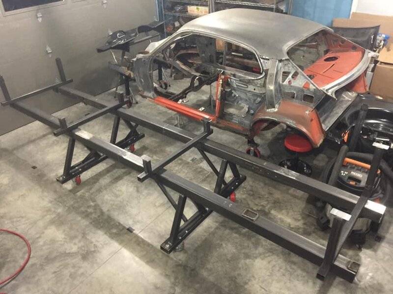

Nice to have a frame table to use. On my ‘65 Dart I made a bracing sub-structure that I welded to the car before removing everything. I had to replace the quarters on both side and replaced the whole thing including the jambs. Also the floor pans, trunk floor, drop-offs, outer wheel houses, part of the brace from the roof to wheelhouse on both sides, the trunk surround, shock mount, and the rear package shelf with the adjacent part of the rear window frame. Amazingly, the rocker panels were good. Some of it was due to old damage that had been improperly repaired. Everything came from donor cars except for the lower rear quarter I had to replace on one of the donor quarters. Everything checks out according to the factory frame chart, but I would really liked to have had access to a frame table and jig. I’m sure that doesn’t exist for early A’s. You have a nice car that will be nicer when you are done.

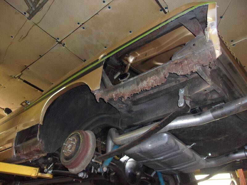

The other side is worse around the window and roof. The spare tire tub like the quarters were all ready patched 3 times . all rivets and bondo. No welds.

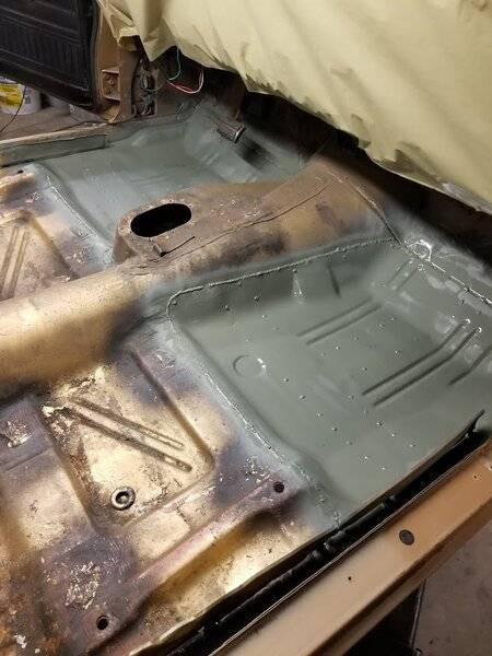

Wow! I guess this kind of thing is pretty common back east. I learned a lot from just looking at these pictures. My left rear quarter had been patched the same way. Rivets and bondo, no welds. A rear sub frame section had been stick welded on and was pretty ugly. Thanks for posting the pictures. Very informative. I welded in the right front floor pan very much like you did. Makes me feel better about what I did. First (and last!) time I’ve done it.
Your project is looking good. I'm currently welding welding in rockers, quarters, outer wheel well, trunk extensions (no trunk floor), etc. I can't imagine what a shop would charge to do this work. I also did the front floor in sections too. I welded in frame connectors to stiffen the car up...killing 2 birds with one stone. There has been a few lessons learned. I should have never tried to butt weld the rear seam of the front floor pans. Also, changing a complete rocker is a big job and disturbs (destroys) lots of factory welds. I will just be welding in sections on the passenger side. Live and learn.
