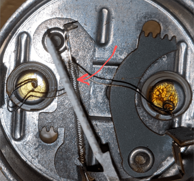

If you gauge looks like this, it's toast. It might still work to so.evextent but the bimetal has been over heated and permanently bent more than it should be. And the insulation on the wires of the heater are most likely fried as well.
This image is an aftermarket replacement gauge so the needle position for it is normal but it illustrates what a toasted OEM gauge looks like
A good functioning gauge will sit like these two
Here are images of the insides of our gauges.
Note the white, good insulation
Note the burnt black insulation
The gauges are electro mechanical.
There is a heater in the gauge that heats up and causes a bimetal strip to bend causing the needle to move.
Once the needle is pegged to the far left the gauge is toast. (Ask me how I know)
