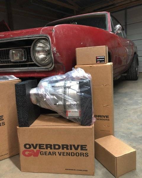

Well it only took a year & a few months to decide on a Gear Vendors. Hopefully get it in this weekend & get the driveshaft made next Monday.
