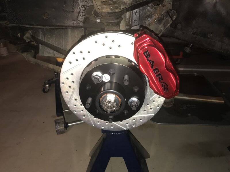

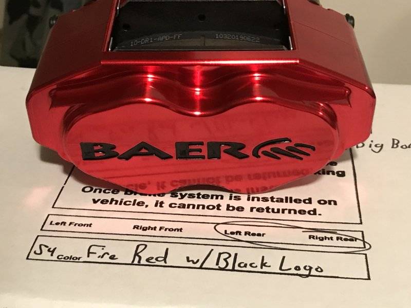

Those are too pertty to put on. Get your car too nice and you’ll be afraid to drive it. But, those are pretty. They’ll look good behind a set of wheels.:thumbsup:
How did the install go? I'm thinking of going with the Baer 6 piston 13" kit with their master cylinder as well. I'd love to hear what you think

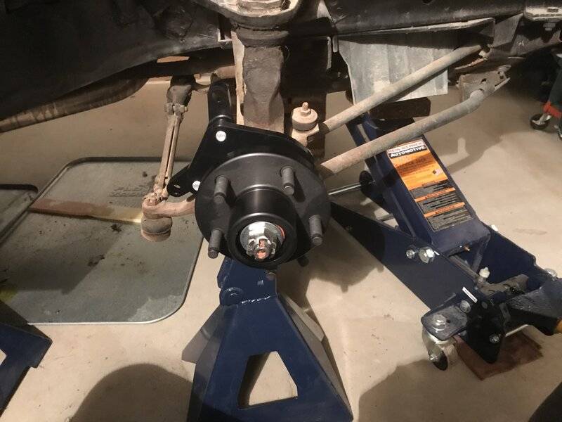

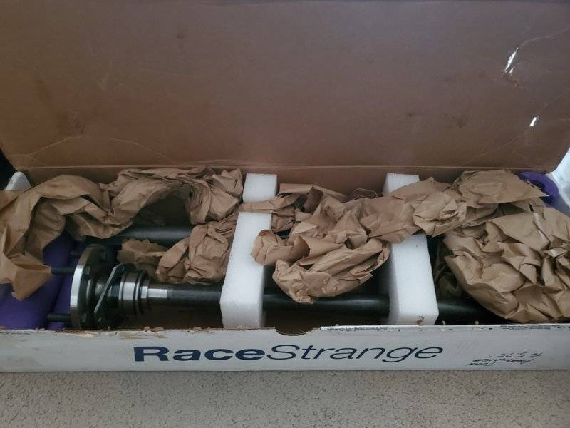

Just got my axles back from having the axle flanges milled down to fit the rotors. I will add the results coming up. Are you doing all four disc’s?

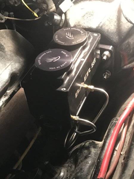

Yes, I have the Doctor Diff rear 11.7" kit and I want a large front brake kit with aluminum rotor hats and lighter calipers than the Viper calipers so the Baer kit appealed to me. I'm running manual brakes so i'll run the Baer 15/16 master with an adjustable proportioning valve.
Are you installing the Remaster master? I have power brakes with the 1” Remaster and disc’s on all four.
Here’s a picture of the axles coming back from the machine shop.
Yes, i'll use the Remaster 15/16 bore master cylinder.
Axles look good, I'm looking forward to the progress once they're on the car

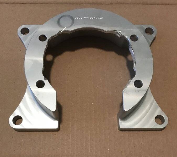

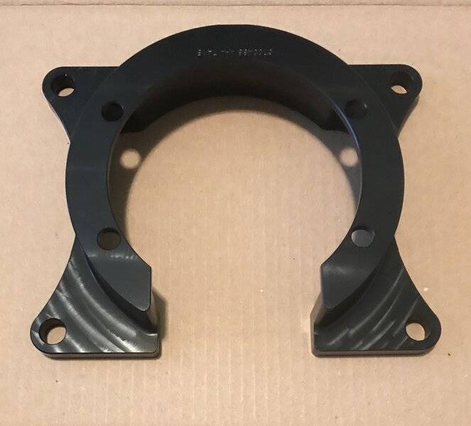

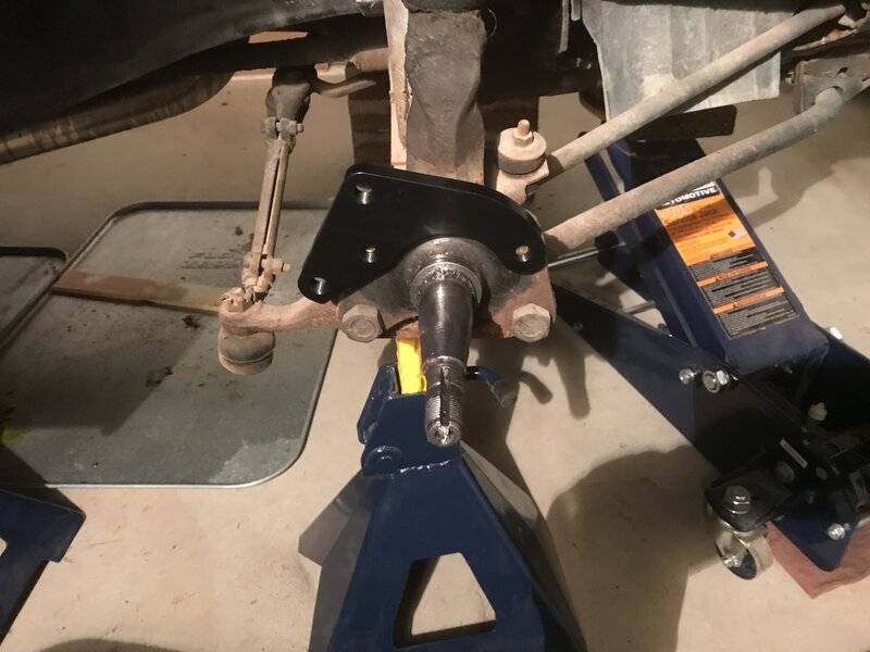

WOW!!!!!!!! nice!!!! How much did it all set u back? Can u please show a pix of the caliper bracket? Thanks.
Just over $2,000 front and back. Here’s the caliper bracket.

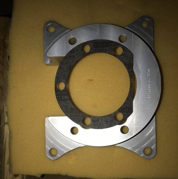

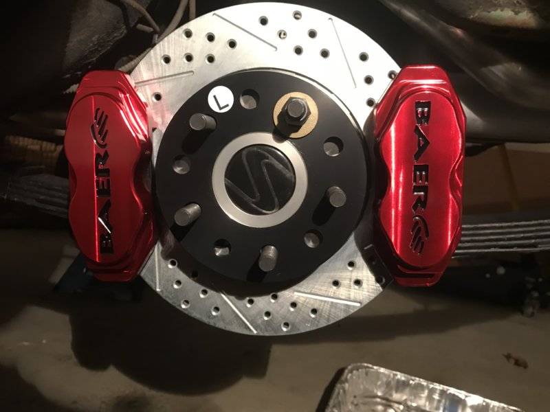

Rear disc brakes bracket being modify.
Before...
After...
