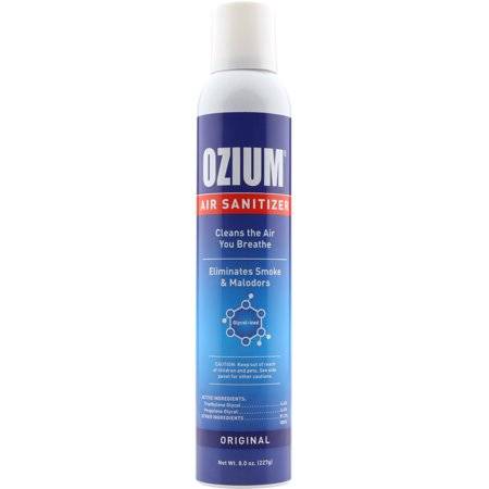

ozium.

Ozium also works good, but same problem as above. I taped the valve down on a can and threw it in the car with the widows up like a bug bomb. I did both a few times. Still just takes some time for it all to go away.
