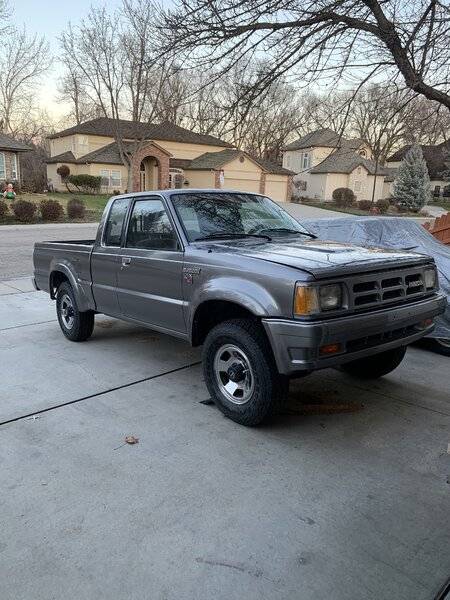

I had to replace the heater core in my 93 Mazda B2600 last week ( well still working on it) so I popped LEDs in.
Whole damn dash had to come out to get to core !

Nope ! Real Mazda
The last year 93
I was actually trying to bust Rusty’s chops, but I’ll settle for multiple victims…..haha
