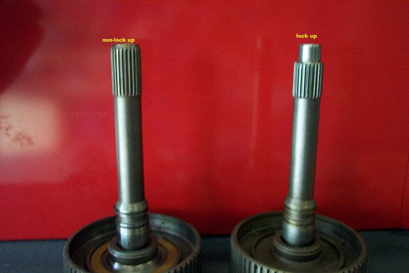

You'll have to match a converter with the trans because they don't interchange
