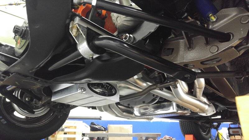

Anyone able to post any underside photos of their small block long tube headers and clearance around linkages, and steering box, etc I've had tri-y's on small block NZ RHD valiants and in-spite of how tight the steering on them is I didn't have any issues. My first thought was to get cheap 304 stainless headers and if I need to modify or improve, easy to do stainless work where I work, without having to worry about coatings. This is for a 360 manual steer 75 duster.
1975 Dart Sport 360, headers from TTi.
Check out post 36 and 37 in my build thread in Restorations. I've got some photos of the Schumacher tri-y headers I installed on my 73 340 Sport. Had to do quite a bit of dinging on each side and it's still close.
1973 Dart 340 Sport Project
73 Duster, 408, manual steering. TTI headers. Everything fits just fine - no more then about 1/8" clearance between pretty much everything but if nothing touches then anymore would be a waste.
